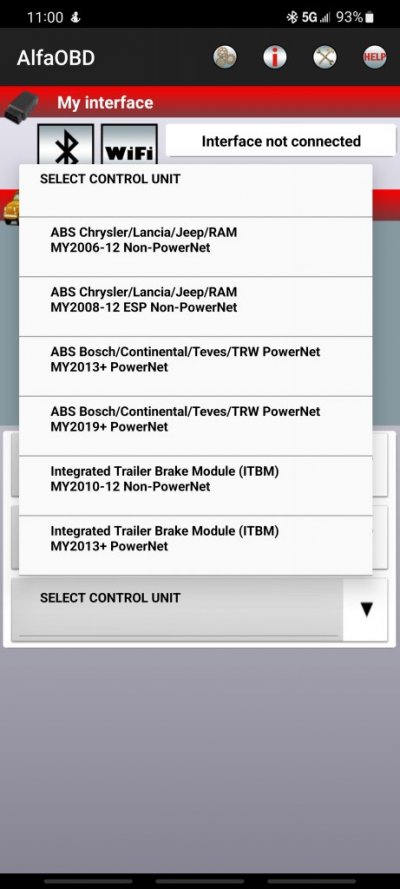

Hoping someone can help with this. My screen shots were taken when NOT connected but I was connected when attempting all actions. It seems I had no issues changing tire size but when I go to clear the ABS faults I am not seeing an option for "ABS Ate/Continental"
The only option that really applies to my truck (ABS Bosch/Continental/Teves/TRW PowerNet MY2013+ Powernet) does not enable the Start button. The instructions seem to indicate that maybe I need to go thru a different procedure but obviously I am hesitant to do so as I am not looking for a disaster. Really, I'm wondering why I do not get the "ATE" option.
Any insight or help is greatly appreciated since my truck is now sitting in the garage with a bunch of fault codes. Thanks.
I’m having the exact same issue. Has anyone figured this out?
