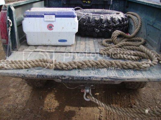

Some people also like to use big rope for recovery which is fine too, so here is what you need to know. How to make an eye splice, and the ropes strength. A knot reduces breaking strength by 40% while a splice retains 95% of the ropes strength. Most people say the rope will break before the eye splice will come apart.
Here is a picture of the splice, literature will follow.

Finished product tested.

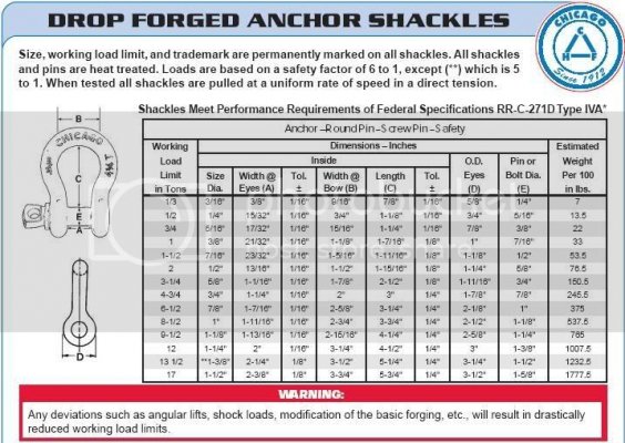

Shackle Information Chart. From http://www.chicagohardware.com/catalog/09_10_shackles.pdf
Here is a pic for those who do not have Adobe reader.

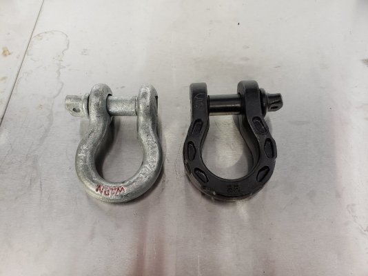

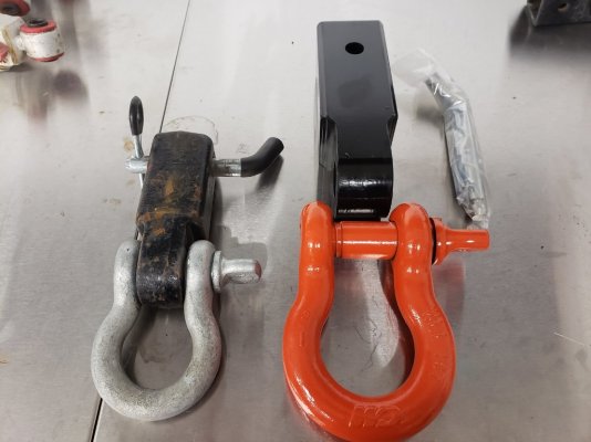

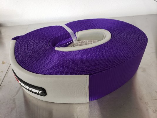

Upgrading some more recovery gear after the change from Jeeps to a Power Wagon ...
Always used the Warn shackles on the left for Jeeps, rated at 18,000 lbs. I changed to the GearAmerica shackles on the right for the Power Wagon, rated at 68,000 lbs.
Changed from a Warn snatch block rated at 12,000 lbs, to a GearAmerica snatch block rated at 20,000 lbs.
And added something I haven't had before, a winch extension strap from ARB, which is designed not to stretch. 65' long, and rated at 17,500 lbs.
This has been interesting upgrading my recovery gear. It turns out that GearAmerica has great products. Their quality is equal to ARB, and a little better than Warn, for about half the price.
Is that a typo? I zoomed in on the shackle and it says 8T (16k lbs, not 68k lbs)
