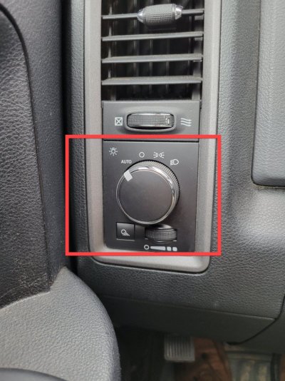

The light control does not have a button for fog light. There is a button for rear middle bed light, and that's it. The turning knob controls auto, on, off etc..

That's the round knob I mean. It has no control for fog or anything.20240413_155848.jpg

@zafo that might be the wrong headlight switch for the OEM fog lights control as you push the knob to turn the fog lights On/Off.

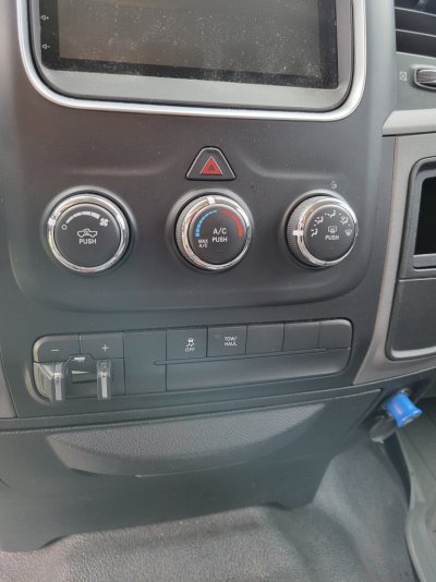

Does this truck have the up fitter switches under the radio? it's possible they wired the fog lights to one of those.

This is how it looks under the radio. Just two switches about towing.beow radio.jpg

Previous owner probably installed fog lights along with bumper with the cutouts and never "finished" the job to actually get them to work. My tradesman didn't come with fogs. I purchased the bumper with cutouts, fog lights, headlight switch with fogs, and @Mpgrimm2 harness. Also activated them with alfaobd.
Lookup your build sheet for your truck and see if it actually came with fogs. Since it's a tradesman I doubt it did.

Sounds like it was. I don't think they ever put fog lights on the tradesman models. Now that I added them to my tradesman everything looks and functions as if it came from the factory. Sounds like you'll need @Mpgrimm2 harness and pin it into the fuse box (if I remember correctly, it's been a few years). Very simple to do and he gives excellent instructions on how to do it. Buy a headlight switch that also controls the fog lights. Then lastly have a dealer flash your bcm so they actually work. Or like I did turn them on with alfaobd.
Or I suppose a guy could skip all that and wire them up to a separate switch and install the switch somewhere.

On my 2013 the round headlight knob controls the fog lights by pushing the whole knob in. The headlight switch as to be in parking or headlights mode in order for the fog lights to come on when the dial is pushed in.

You're headlight switch doesn't have the center button for fogs.
Not sure if the bumper has the OEM bumper harness between them or not that ends in a 4 pin connector behind the left side ...
See:
- DIY: Add 2013-2018 OEM Foglight Wiring
