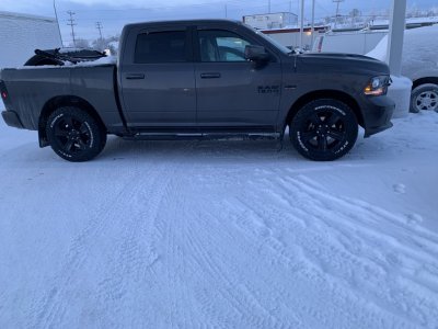

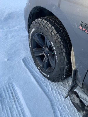

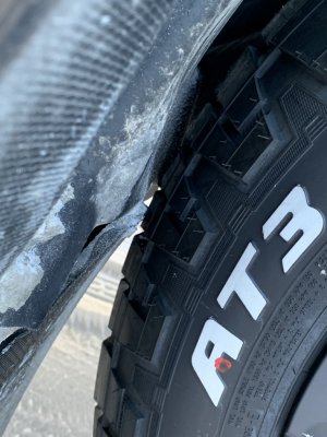

martinrk
Jan 19, 2021
18
31
yellowknife NT
275/65 should be fine. You can use alfaobd to update the speedometer for that. You may want to look into a small leveling kit with the tires but probably not 100% necessary
I just put on some 275/65R20 Cooper Discoverer AT3 XLT, I like the tires, got slight rub on my mudflaps at full lock. Just received my bilstein 5100’s yesterday and waiting on bilstein rear coils to come in.
