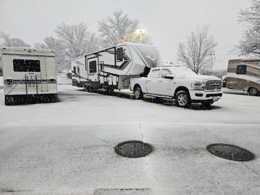

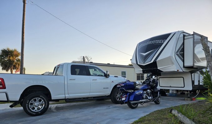

Hello, Back in December I bought a 2023 RAM 2500 diesel with the Laramie package. I was looking for something to pull our Grand Design Toy hauler. The toy hauler has a GVWR of about 16800 fully loaded. I know I should have bought a 3500 but this was too good a deal to pass up and I'm not planning on trading anytime soon. I added Air Lift 5000 air bags and to be perfectly honest, this setup tows and stops the trailer just fine. We just did a 3000 mile round trip to Florida and a lot of the time I didn't even know it was behind me. That being said I'm looking at upgrading the rear coils to the CARGOMAXX HD coil springs. My reason for doing this is, I'm just looking to add a little more insurance while towing. I have to put 90psi in the airbags when towing, the max is 100psi and I don't want to risk an airbag blowing out. Supposedly, the Cargomaxx HD springs give you 35% more payload capacity. Has anyone installed them or something similar? Any input would be appreciated.

Have you weighed the trailer while fully loaded to see where your weight is at? Might be worth running over the CAT scales to be able to adjust the cargo in the back to alleviate excess pin weight. Toy haulers are nose heavy when empty in anticipation of cargo acting as a counter weight.

I have a '22 laramie 2500 4x4 ccsb with the 6.7 cummins and tow our 32' 10,000# 5th wheel with it. lighter than yours and it tows fine and I added airbags to it. hooking up the trailer only lowers the backend of the truck less than 2" so I havent even added air the last few times I towed it and that seems to ride smoother that way. I have the factory puck setup and a B&W hitch and all is good. my son has the same truck and the same 5th wheel and he goes with 60# I think. his rides rough that way so he bought an air ride pinbox to make things smoother. my way was cheaper and the ride is fine. maybe consider the spring swap or air ride instead of going stiffer, go springier..BTW my cargo cap. is just 2060#

I'm sorry, but in my own opinion there isn't a 3/4 ton truck on the planet that can tow that toy hauler safely without being extremely over on every rating. Especially a Ram 2500 diesel with a payload of 1900-2200 lbs. That 16k 5th wheel toy hauler with nothing in the garage is going to have a pin weight of around 4000 lbs. Toy haulers have extremely high unloaded pin weights to offset the weight of a vehicle in the garage.
That is 1 ton dually territory.

While I think this is an extremely overloaded combo and while I would absolutely never under any circumstances recommend trying to "make" the truck do something it was never intended to do.... here we are and I'd rather try to help keep the guy right side up. There may not be room in the garage to move the cargo back to alleviate pin weight.
First things first... airbags do nothing to help payload and you've got probably close to 4k on the truck with the garage empty, and depending on what you're hauling in the garage that might come down to ~3,300-3,400 lbs. All of that weight is still sitting on the axle, so keep that in mind. There are no HD coil springs to correct this much issue. If you "really" insist on keeping this combo (which I adamantly advise against), I would suggest swapping over to a 3500SRW leaf spring suspension.
Both the standard output 6.7 with the 68RFE 2500/3500 SRW come with the 11.5" AAM axle. You get a 12" axle in the HO/Aisin combo. Upgrade to the Hotchkiss (factory) leaf spring assembly, ensure that your tires are capable of handling the weight, and then consider airbags if necessary (they likely will be). I would even consider adding the DRW helper spring and spring perches. This is 100% dually territory all day long but you can "make" the truck do it a little safer than the band aids you're trying to put on it now. All assuming of course, that you stay under the RAWR.
I would still say that you need a dually, but this alternative is much better and safer than what you're currently attempting. More costly, yes... but if you're going to do it at least do it right.
