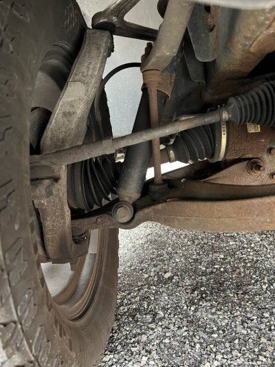

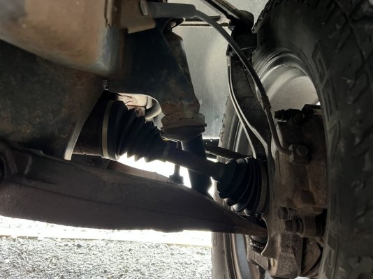

Installed new torsion keys and leveled truck 2-2.5” in front.
Are CV angles to steep? Or should I be fine?
Any body have picture of ideal cv angle after leveling?
Waiting on new shocks so just wanna know if I should bring back down some to avoid issues while I wait.

To me from the pics it does look a little on the steep side does it viberate or anything? Ya might wear them out faster common issue when people lift vehicles for example every couple years i gotta do upper balljoints on my jeep because of the lift.

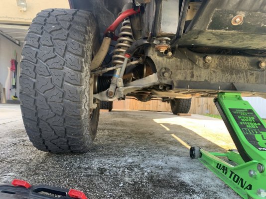

It looks a bit steep and l can imagine it’ll get excessive wear from the angle. You want the cv angle as close to flat as possible. My truck is a 2017 so not the same but this is just a point of reference. First picture is cv angle with leveling kit. The second picture is max cv angle my truck will ever see with the front lifted off the ground.
