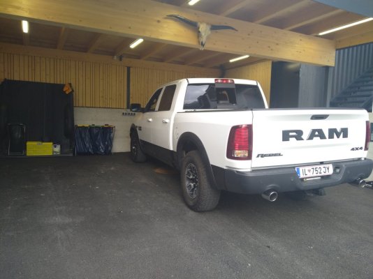

I'm new here... Read all you posts and followed all of your instructions... But i've a real major bug in my system i have to tell you...
Everytime i go to write suspension height values, the truck levles it self to his normal height i think - so far, ok...
But in this time it is just saggimg really bad to the left in the front and rear... So it goes down more left than right... About a few inches... But i am able to lower the truck on all corners normally - till the errors come up...
Sry for my english i'm from austria...
Please help...
