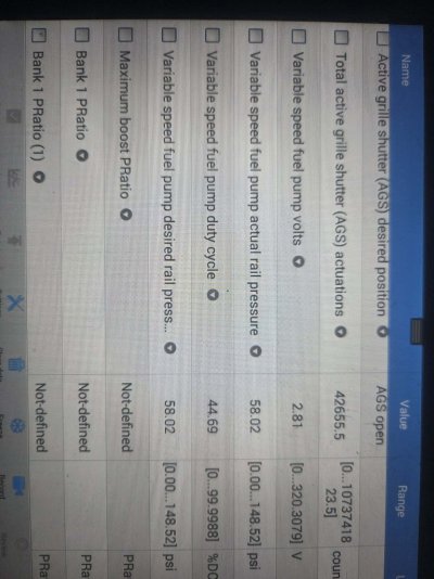

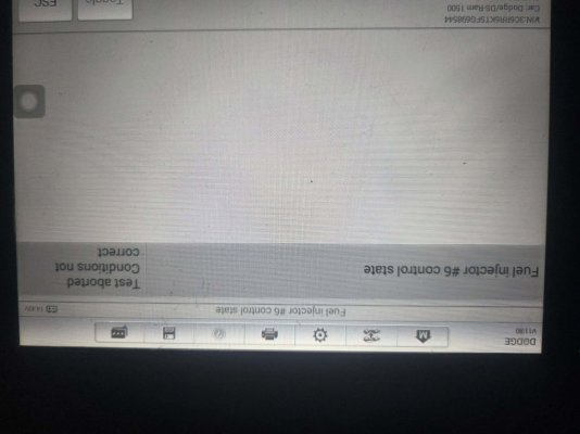

Unsure where to begin. The truck started missfiring and had trouble starting. I will attach all the codes and explain what trouble shooting has been done. The Fuel pump was changed but only made things slightly better.
It seems like she is starving for fuel. If I prime it using my tools she will start right up, run good. Then, it starts to die down. When it shuts off, It won't turn back on until you prime it again. There is a restriction somewhere in the fuel system
Prior my purchasing the truck this kit was installed. The install was done April 2024.
The heads were sent off at the same time. And MDS delete was done as well.
https://www.amsracing.net/collectio...2015-5-7l-hemi-engines?variant=11532742524964
The missfires I am having are on Cylinders 6, 7, and 8.
Put a larger diameter fuel line on the fuel rail pressure sensor to see if it could put us at the desired fuel Rail pressure. Still didn't fix the problem, it was running smoother, but it still shuts off on us.

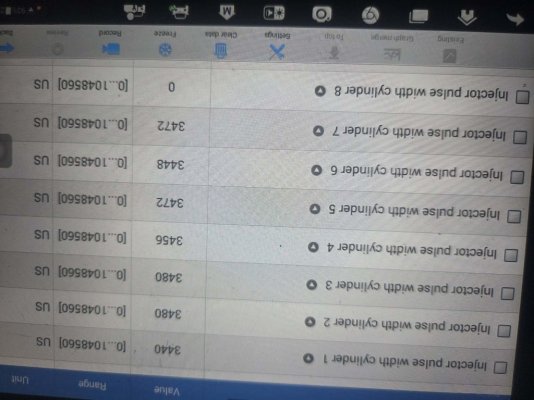

6 7 and 8 still misfire 6 7 and 8 injectors play ring around the rosey. I don't know when they want to work and when they don't want to work. Am thinking it could be the fuel injector which seems weird because they come on anytime I command them on. That and I swapped six and eight, with two and four, and it didn't switch which the cylinder was misfiring i tried researching what would cause those injectors to sometimes work sometimes not work.
Fuel trim is single digits which suggests ignition issue. It is also no longer getting any low fuel pressure codes pending active or past.
I keep getting thrown off. Because I have swapped injectors. I have also swapped spark plugs, and coils. I also can't seem to find any issues with wiring. Compression was checked but only on Cylinder 6 and it was good.
The photos on this thread reflect updated codes. If needed I will post original codes as a reply. Any help would be greatly appreciated as I am at a loss.
