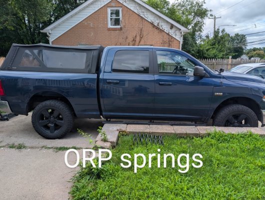

After digging in and doing some research, it seemed 5th gen rear coils were drop in replacement options, and offered a variable rate coil compared to what we have for the 4th Gen stock. Their Off-road Package (ORP) springs offered an inch of lift over their normal ride height option. When digging into it further, the ORP rear coils are stupid cheap, like $25-30 a piece cheap, part number 68262684AB.

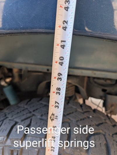

The issue I was facing was that last summer I replaced the rear shocks and coils with Bilstein 4600s and superlift 2" coils. The 4600s were too short, literally nearly completely extended at just normal ride height. So, I had to add an extension. The rear, with the superlift coils, sat higher than I wanted, somewhere around 2.5" total lift over factory. Gave me a lot of rake, and I believe these coils were stiffer than OEM. While initially, they seemed to ride better than what I had, OEM shocks, springs and 1.5" spacer. I started finding that the rear did not want to stay planted. Likely source was probably the control arms, but I was still sitting higher than I wanted in the rear. If I had a constant 500+ pound load in the bed, it likely would have sat closer to where I wanted. So, after doing some digging, I decided to order the ORP springs from @AllMoparParts.com and had them here in 2 days, ordered a set of knockoff rear control arms, and had already had a set of rancho rs7mt shocks delivered. I went with the ranchos because the specs on them list them as a progressive rate valving instead of digressive, hoping they'd ride a little softer than the 4600s. Saturday evening I tore into my truck and had the driver's side stuff replaced. Sunday morning, I knocked out the passenger side. Quick drive around the block to get things to settle, was showing I was sitting at about 1.5" of total lift over factory. Much closer to where I wanted to be. Ride quality was still up in the air. It's hard to try and isolate the front from the rear, especially when traveling at higher speeds. I didn't want to make any judgement until I can test it out on certain parts of roads I use to drive to work. Where these bumps would cause the rear to want to skip and shift towards the outside at highway speeds. Well, after a drive into work, I can confirm that the truck is far more planted in the rear, the rear suspension feels less harsh over small to medium bumps in the road. The 5100s up front feel stiff, and jarring. I'm really disappointed I spent the money I did on these, and wish I'd have gone a different route to begin with. So, all that said, if you're looking to lift the rear of your 1500 about 1.5", go with the coils I listed. The price is similar to that of a spacer lift, but with better ride quality, and should handle heavier loads slightly better, being a variable rate. The following pics are before removing the superlift coils.

The following pics are from after I installed the ORP springs, new shocks and control arms. I can also confirm that any axle hop I had, is now gone. So, I can do burnouts without the rear shaking itself apart.

Installed a set of 2021 rebel front struts, the OEM yellow Bilsteins, yesterday. Front dropped to about 3/4"-1" higher than my stock ride height. However, ride improvement over the Bilstein 5100s and the Moog cc81764 springs set at position 5 is drastically improved. I suspect the biggest issue I had with the 5100s was that the Moog spring being a variable rate, had compressed to the stiffer end of the spring when preload was applied. This meant it was like riding on 800lb springs, extremely stiff, and with the coils collapsed very close together, was likely nearing coil bind whenever it did hit a bump. So, now my truck is essentially sitting on a 5th gen rebel suspension. It rides noticeably better, but it does appear to me that the spring rate on 5th gen trucks is slightly softer, likely due to slightly lower curb weight of 5th gens over a similar 4th Gen. I'm not exactly crazy about it being lower, but at the same time, the ride has significantly improved over what it was, and I am not disappointed with that. Plus, it makes it a lot easier to get stuff out of the bed, which is kind of where this whole project started.
