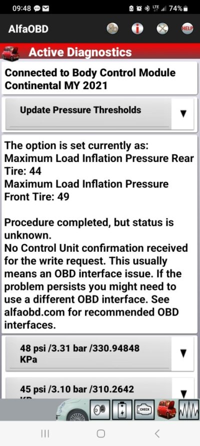

So, turns out the issue was NOT the OBDLink software upgrade. Apologies to them for wrongly blaming them. However, have still not heard back from support.
Turned out to be a very simple error. When I plugged the bypass cable connector into the OBD port it wasn't full and square. It had pin contact to read existing settings but wasn't in far enough to actually write the changes. Once I full seated the connector everything worked perfectly. Hope this helps others. This is the error message from the unseated connector. Screenshot_20240703_103035_AlfaOBD.jpg
What twigged me, after I downloaded the older software version, was I tried resetting the tpms limits as a test. I knew for sure that worked fine so when it didnt work with the old link software and gave the same error message I went looking for other causes. Screenshot_20240703_094840_AlfaOBD.jpg

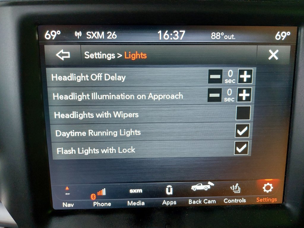

Where does the option to select drl or turn them off show up. Have looked under all the categories in settings and the apps screen. Dont see it. Thanks.

Thanks for confirming. That is where my owners manual said that is where it should show up. Have all the options set right so we shall see if that shows up in the options in a day or so.

Success. Two days later and a few cycles of running a few places and the DRL option now shows right where it should. With DRLs off I still have the signature lights or eyebrows so am going to playaround with turning them off. The DRLs when they are on are still the Canadian default low beams so that works just fine. Thanks a bunch for the help RamDiver.
