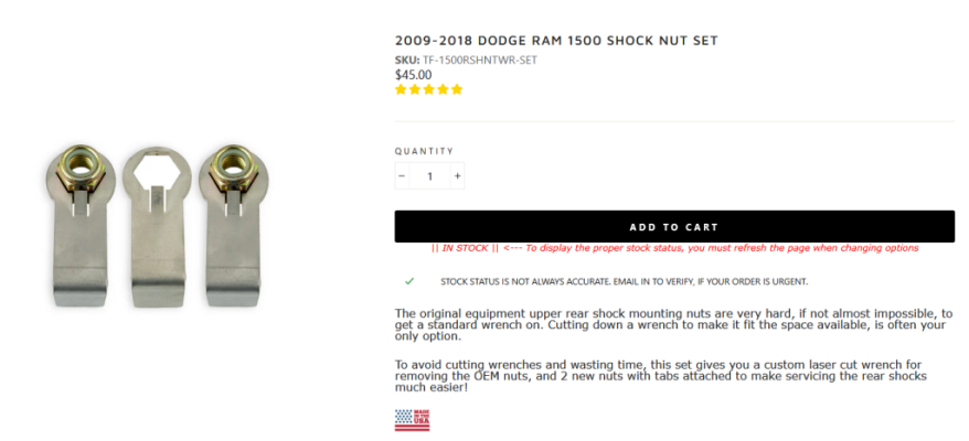

either way, if you decide to do the rear shocks yourself, gonna need a 5.5 inch, 21 mm stubby open end/box wrench to access the top nut. i found one on Amazon made by Klutch. only one that i was able to found. Made the job easy..........SK makes one ...

I bought some thin metric wrenches for a German car I recently sold and I have a grinder or 2!

you can use a 21mm crowsfoot or you can buy these things though I think 45 bucks is a bit hard to eat
or buy the cheapest harbor freight 21mm box wrench and cut it stubby with a friction wheel (a saw that uses teeth to cut will struggle with tool steel)
