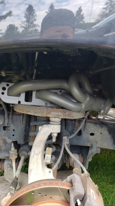

Jba have been hit or miss depending on year... in 16 they changed the collector slightly and dont seal as good...also there has been issues with cracking...if your just wanting to not have the broken bolts... I'd suggest just replacing the bolts 1 by 1 (1 old one out and 1 new one in) with lock washers and regular washers... m8 bolts 1.25 x 45 is perfect fit. That's what I did ...and I had jbas sitting here when I made that decision... sold them for abit.more than I payed so didnt lose out
So far so good ...I would do long tubes but just dont wanna be bothered ... will eventually just add the afe y pipe to replace the squished one we get from ram942e094b5af5243d9a9eb9719aba026a.jpgc05296b064695116cae69d9bf24c9d24.jpg

Interesting... but what about the one's with the stud on them? Did you just leave those covers off?

Yea ...no issues with it melting anything... just have to bend the bracket on the dipstick to mount either to a coil pack or brake booster..4wd vs 2wd is another thing to consider as a 2wd install is going to be a hell of alot easier than 4wd, if your doing it yourself for jba. I'm not against them as I too was going to install but didnt want to have them not seal or crack and then have to take them off and either fight warranty or spend more on them dab9459be2a4033853c221138d41e8ce.jpg
