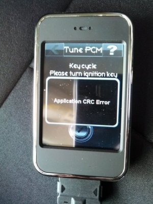

jbr
Aug 25, 2013
1,179
226
Long Island, NY
So I went ahead to load the hemifever 89 tune and it went through the cycles and then it seemed it hung up and then said error. Unplugged it and loaded again and said in recovery mode and stated loaded last back up. So the intune dcx loaded that and said successful. I guess I am back to stock now....
How do I know if I am in the stock tune now?
I wonder what caused the error writing to hf 89?
Any suggestions?
