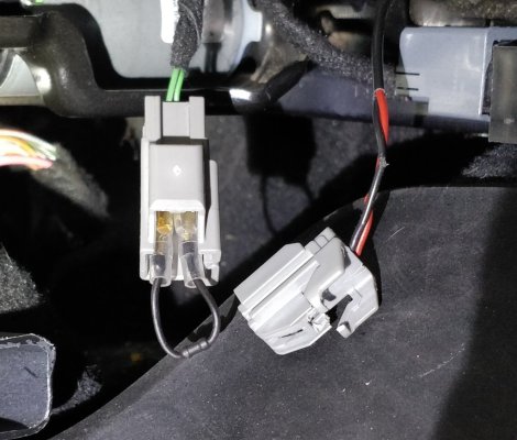

Just an update for this thread. I ended up doing some testing and I found that a 550 ohm resistor across the two connector terminals will make the truck think the seatbelt is always connected.
I cut my seatbelt wire and soldered across it. I tried several values before finding this one that worked.
Thanks @Bmags ! I crimped a 470 Ohm resistor to 2 mini spade connectors then plugged it in instead of the seat belt sensor. The spade connectors fit the terminals so it did not require any cutting. The resistor is shrink wrapped to prevent it from making electrical contact with anything by accident. I did not have a 550 Ohm resistor but the 470 Ohm resistor I had on hand works great. I included a photo if anyone else is interested in a similar solution.
For anyone wondering, I always wear my seatbelt while driving but I like to put it on while backing out of my driveway, before the road. The truck will not automatically disengage the parking brake unless the truck thinks the driver's seatbelt is plugged in.

Awesome! If I cared more I could have tested the high and low values to see what the limits were, but I'm glad it worked out. :)

There are two issues here though, and the fix depends ultimately on what someone is trying to accomplish.
Silencing the buzzer is fine if you just want to drive (with doors closed) and no seatbelt on. However, in my case I want to drive with the door open (cracked a bit while I’m backing up for instance). In that case, it’s not the buzzer that’s the issue, it’s the auto-park feature that shifts into Park so you don’t run over yourself. In that case you need the system to think the belt is buckled so you can drive with the door open.
