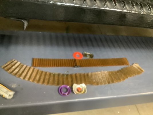

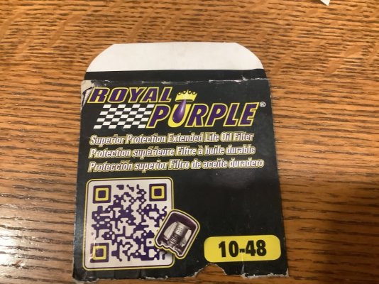

For the size I can fit in my 19 classic 5.7 is puny compared to everything else I have , but I’ve settled for RP 10-48 or wix are image.jpgIMG_4453.jpegIMG_4020.jpegwell built and I’ve cut a few apart.Started to be hard to get.
