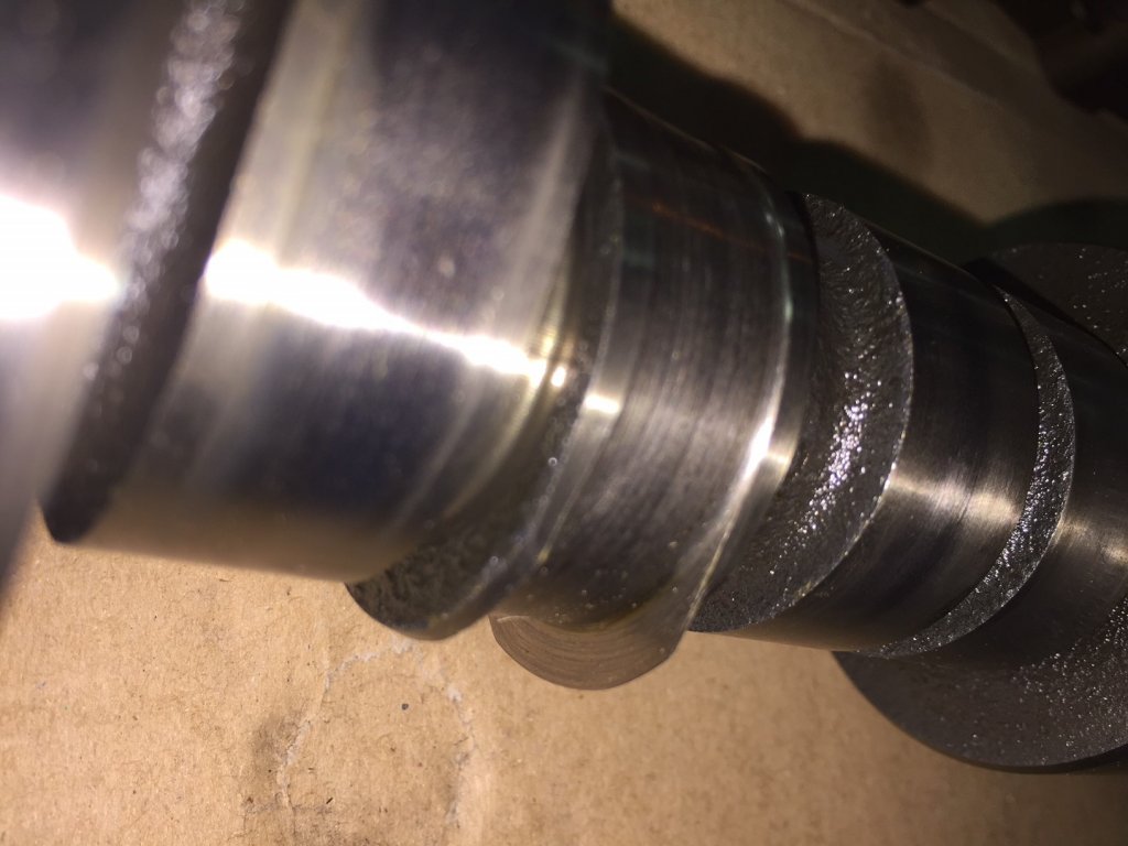

I will admit, performing the cam swap on this truck and engine was actually easier than I thought it would be. For me, it was just time consuming. But if I went back and did it again, it'd probably only take me 8 hours or so.
As for a write-up...I will see what I can do. I didn't take many photos throughout the process. I do however have the service manual (most of it) for the 2010 truck, which I acquired during my days at FCA. That helped tremendously.
Here are the photos of the bad camshaft and culprit lifter:
Hemi395
Mar 18, 2013
9,505
17,670
Cape Cod MA
Wow that's bad it's completely worn down. Looks like the cam wasn't hardened properly...
Burla
Apr 28, 2012
27,545
57,761
2010 Hemi Reg Cab 4x4
dude, was there any ticking/knocking prior to that? That is gross, **** happens way too often on these Hemi's.

2010
Was that an intake or exhaust lifter?
It was an intake lifter. I did a lot of diagnosing in hopes that it wasn't this problem. But I should've just pulled the cylinder head cover in the first place. You could see that the intake on cylinder # 2 was barely lifting when compared to the others.
Damn..!
I've heard that when engine is ticking or knocking, that's when it's slowly eating at the cam to make it look like this.
Is that statement true or we don't know?
Are lifters ticking just during their normal operation?
Well I didn't have any noises that were alarming. There was a SLIGHTLY louder tick that started one day, but nothing that made me say shut it down for good until I find the issue. I only had the cylinder #2 misfire code and bogging down when under load/acceleration. It started out as a nuisance, only barely noticeable misfire. But now that I look back on it, it did get worse over time. I drove it for a month or so with the intermittent misfire. So that probably explains why the camshaft was gouged so badly. But after the replacement camshaft and all new lifters, everything runs well now.
