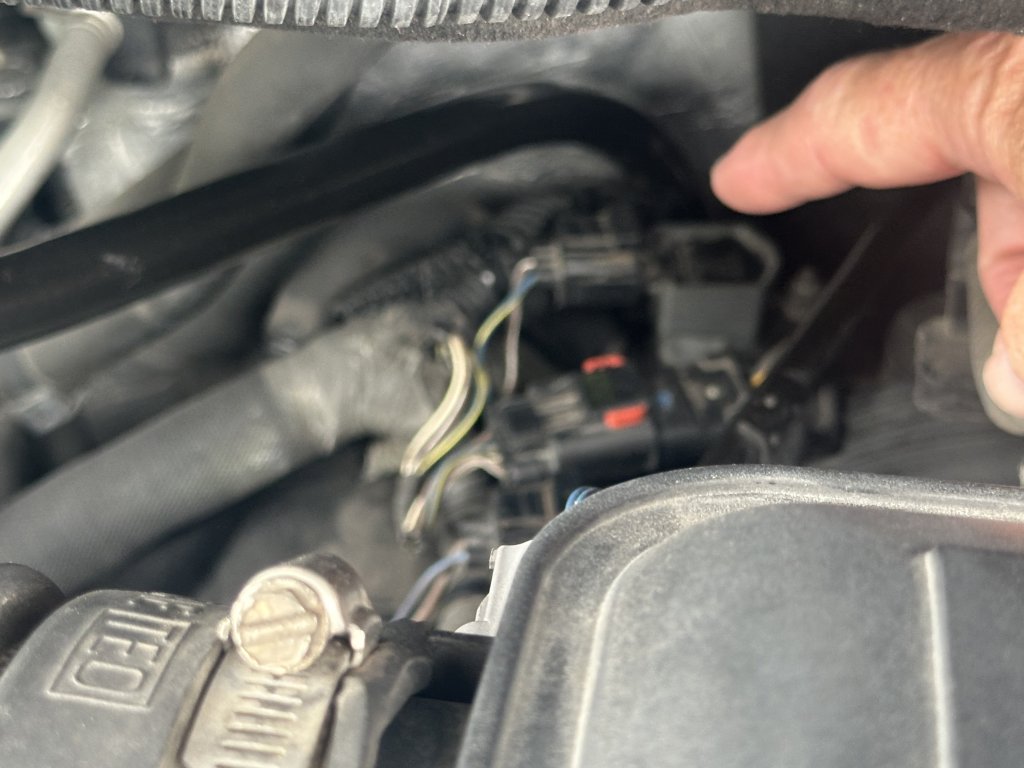

I know this is an old thread. My 2018 Ram 2500 with the 68RFE has very similar symptoms as OP. Something mine is doing (or rather not doing) that OP didn't mention is my +/- buttons on my shifter do absolutely nothing. They just don't work. Other than that, my symptoms are almost exactly the same as OP. Local shop wants $10k to replace the entire transmission. I haven't tried to replace the valvebody yet. I'm trying to determine if the valvebody is the issue before spending money on it. If the problem is indeed inside the trans, then that $1500 is just wasted. @yoda you mentioned a pin fitment gauge. Any idea where I could get one?
This is my first diesel truck, and I mostly daily drive it with occasional towing. Definitely not into max HP/TQ. I bought the truck T&D'd but leave the switch in the #1 position.
