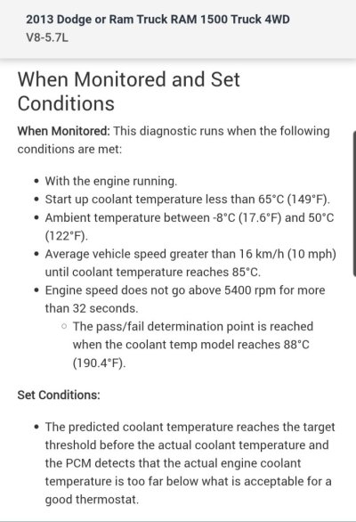

Update: Got the first P0128 code the other day. Funny thing, Alfa did not pick up the code, but torque Pro did...cleared it. Coolant still maxes out at 185° F during normal driving below 75 mph. Sustained runs of 80 mph (toll roads) for 30 minutes or longer coolant creeps to 190° F max. I'll clear the code if/when it returns and thinking about installing the smaller ID plate (5/8") and give it a go thru our mild fall/winter/spring season.
Heres the code set criteria for P0128.
Looks like its looking for 190⁰ to be reached by a predetermined time and if it doesn't reach 190 by that time, it sets the code
Looks like its looking for 190⁰ to he reached by a predetermined time and if it doesn't reach 190 it sets the code
A few guys who've got the thermostat rational code have said after clearing it a couple times,it usually doesn't come back.
I've never had the code pop up in anything i've stuck a 180 in,and that's quite a few vehicles now,so it's very hit or miss on whether you'll get the code or not.
I've started to wonder if it might have anything to do with whether the vehicle is parked outside or inside
Same here, I've ran 180s before and never had this code pop. My truck lives outside so like you said IDK if that has anything to do with it.
But all the 180 tstats I've run hit 190+ on the first opening of the tstat and then settle at 185ish. So mine always hit the magical 190 threshold before dropping below 190
There's several cars running around here with thermostat deletes in them,and as far as i've heard none of them have had the code pop up,but all are parked inside,which is when i started to wonder if that had anything to do with keeping the code at bay.
The 2016 SRT 392 Challenger i've been working on lately has had a thermostat delete since last spring,and i figure that car was a good test,as Dan fires it up and uses it to drive his daughter to school which is only maybe about 1.5 miles from his house,then comes home ,he uses the car alot for short trips around town,where it hardly gets up to operating temp,and it's never once thrown a code,but the car is always parked inside

Interesting, its like certain PCM calibrations have different parameters for setting that code than others. You would think something like this that could potentially be tied to emissions would be similar on all calibrations for the same motor.
But yeah, this was my main concern with running the restrictor plates...
I'd bet that it has as much, or possibly more to do with the state of the cooling system itself.
Given all the posts here on the forum by people having cooling system concerns, reporting numbers that are all over the place, yet still considered normal, it's seems to me that there is a pretty big performance variation from truck to truck.
Mine runs 192*, pretty much all the time. Occasionally it'll get up to 205*ish while towing, in summer, up Snoqualmie pass. Others commonly run 215-220*, downhill, in a tailwind, in winter.
I'd bet that some cooling systems take a lot longer to reach the pcm's programmed threshold, and others much quicker.
