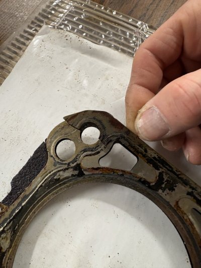

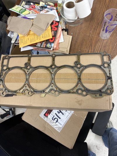

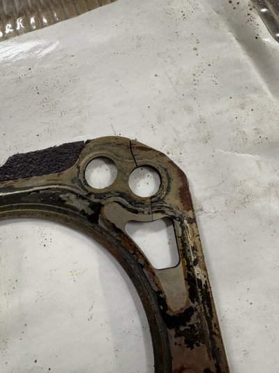

Well I wrote a similar post, besides doing cam/lifters and thermostat, had a random spike in temperature, coolant level was down about less than 1/2 gallon, topped off several days later leaking on left side back as you see in pictures, take in consideration my truck is an ‘18 with 60+ thousand miles, its sad to see it failed at such low mileage, carefully check over all your coolant items so you don’t end up with what I had to fix
