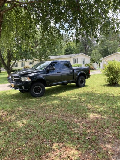

Only advice I can offer is to keep in mind the hoods on our trucks sit higher than the beds, a true level- by measurement from the fenders- will appear nose high.
My truck is 3/4” lower in the front, but looks level IMO.
I want to say that the eco-diesels are more difficult to level, less options, but I would check with Nick @GotExhaust. He is a preferred vendor on this forum, very knowledgeable and awesome customer service, I’m sure can help you.
