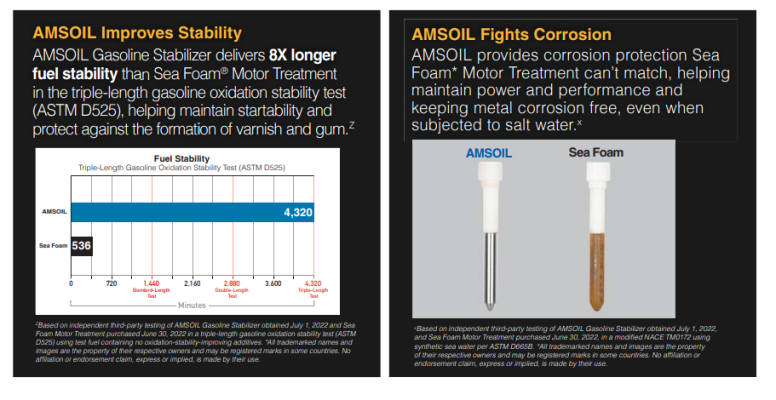

Some light research revealed a few more: PRI-G and Amsoil Gasoline Stabilizer. Both are targeted at gasoline stabilization for storage, NOT cleaning. PRI-G appears highly concentrated, based on low dosage rate, whereas Amsoil is conventional dosage rate of 1 ounce per gallon gasoline.
Of course, Amsoil shows how much better it is at gasoline stabilization than SeaFoam, being SeaFoam is not a primary stabilization additive. ha ha Cherry picking their tests for maximum effect.

Now that we have an industry standard gasoline additive stabilization test (ASTM D525) thanks to Amsoil, it's time for googling SPEC WARS!!! lol
