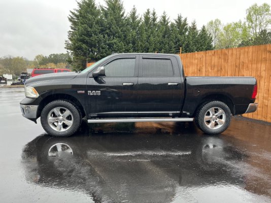

I placed the rough country kit in both the front and rear springs raising 2.5" and 1.75" and the result was aesthetically very good but the ride became terrible.
Now as a further upgrade I would like to replace all the shock absorbers with bilstein 5100 but without using their leveling because I don't want to preload the spring but I want to place spacers on the upright at most 2". I read the 3d at the beginning and I know that you would have to stack 2 different leveling kits but setting the bilsteins to stock mode and only using the 2" spacers above is that a terrible idea?
With this solution can I keep the ucas stock or will I have to change them?
The solution of using the 2.1" level of the bilsteins scares me as by preloading the spring I think I will have a guide very similar to the one I have today and it is really bad ... I feel vibrations everywhere even on the accelerator pedals and brakes and feel every slightest pothole in the road.
I know how you feel about space strutters but I'm very confused and I hope you will help me find the right setup for my truck
