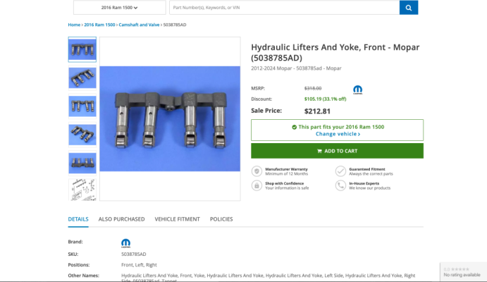

@Burla Okay, found something interesting. I went to an on-line Mopar parts store and put in my vehicle as if I had a 2016 Ram 5.7 Hemi and looked for lifters (1st screenshot). They showed both the rear and front as the exact same numbers I posted in my original post for what RockAuto gave me. The front lifters (5038785) show as compatible. However, when I changed the vehicle to a 2010 Ram, it showed they were not compatible. BUT, I noticed the message below it that showed they were compatible with the listed yokes. I would end up just reusing the yokes I have but they do sell them. Why couldn't they just put a set of 5038785 lifters into the 53021727AC Yokes and make it easier on everyone? I even wrote to their service department asking what replacement lifters were compatible with my vehicle and they responded back that they could NOT confirm the correct part for my vehicle and stated I should check with my local Dodge dealership. SO even they the Mopar parts stores don't seem to know about this.

Thank you but I will not be doing an MDS Delete so I still need both the Non-MDS and MDS lifters. I am also unsure of how to verify whether the lifters would even work in my engine. Believe it or not, I am getting no help from neither a MOPAR Online parts store nor the local Dodge Dealership. They both tell me that "according to their data" I need 5038786AD for rear (which they both have in stock), and 53021726BC for the front (which neither of them have). MOPAR Online tells me that part is discontinued, while the local dealership simply tells me it is on backorder with no idea when they might possibly get them in. Beginning in 2016 the 5.7 Hemi's began using part number 5038785AD for the front, but they both tell me that it is not compatible with the 2010 Hemi, yet neither one can provide any information about "why" it's not compatible. I placed an order for two sets of the 5038786ADs and two sets of the 5038785ADs, along with all the gaskets sets I will need, new water pump, new timing chain and guide set, new oil control valve, new thermostat, and a 2016 Hellcat oil pump, which will bolt right up to the 5.7 Hemi and provide more oil volume at both the low and high ends. That order still has not shipped because they dont have the 785 lifters in stock. I have tried reaching out to the Service Department to see if they can tell me which part number I should be using for the front lifters and I have yet to be successful in getting ahold of someone to tell me or receive any calls back. Very frustrating to say the least. I hope someone, ANYONE, can confirm with me the part number of the lifters I need for the front. I would think I could just order four sets of the 786s and then just swap two sets over to the existing yokes in the correct order of where the MDS lifters need to go, but I haven't found anyone that can even confirm that I can do that. I know there are A LOT of people out there that have done this job already on their 2009-2015 Hemi's...what did they use? And as far as aftermarket lifters, I am trying to avoid them. They may be fine but I don't have enough data gathered to know which ones are good and which ones are junk. I want to get another 100k out of this engine and hopefully more. It has to be done right the first go around. Thanks.
