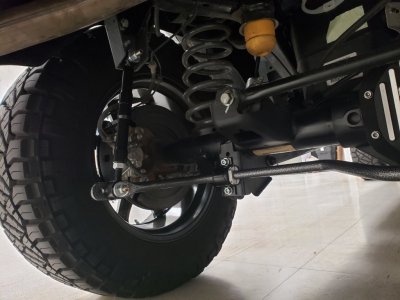

If you want serious solid end links look up core 4x4 endlinks. Damn... I’m running them. They’re solid. I’m debating on the sway bar but I like how my truck rides. Not sure if I’ll lose anything offroad with the hellwig bar flexibility wise. The core arms helped me since I raised my truck. I got custom length arms and leveled my sway bar out.

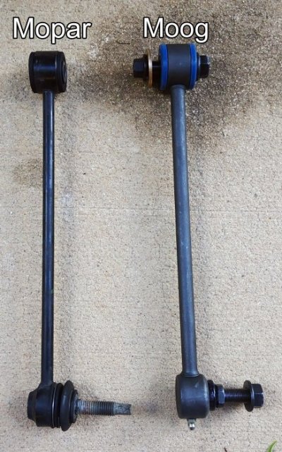

I run Hellwig with the OEM end links per Hellwigs suggestion. The bar itself is where the difference will be noticeable. The end links do nothing extra. Unless you’re end link boots are rotted and dry, don’t spend the extra money, add the Hellwig bar for stick ride height and watch it go.

I'll disagree about the end links. I have the Core end links on my lifted Ram. They are much thicker than even the Moog and have poly bushings. Grease zerts. No rubber. No give. I moved my rear sway to the inner most hole and I honestly feel more of a difference there than I did going from the stock bar to the Heilwig in the middle hole. Nothing harsh about it. Now maybe its different on a non lifted truck. IDK.
